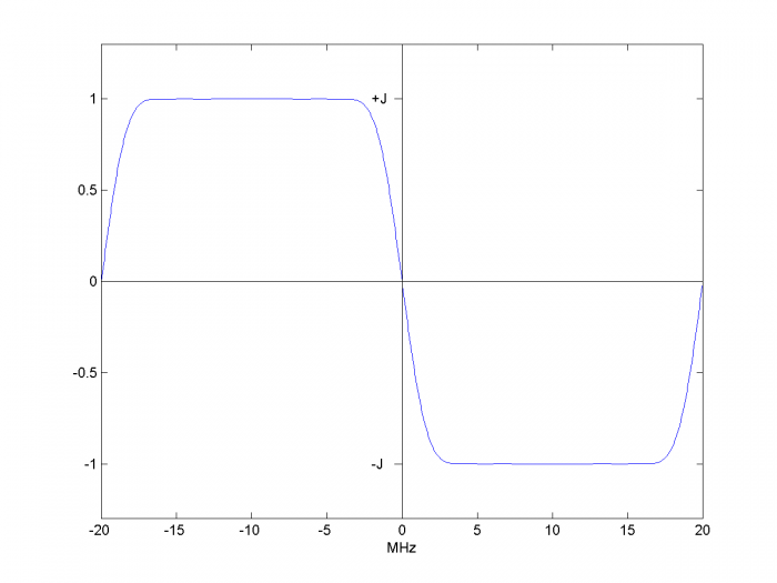

Hilbert Transformer
Here we’ll use the same 31-tap Hilbert transformer presented in an earlier post [2]. Its Matlab code is part of the m-file listed in the Appendix. For sinusoidal input, the Hilbert Transformer generates I and Q sinusoids, with Q lagging I by π/2. The pure-imaginary frequency response of Q/I is plotted in Figure 3. For sample frequency of 40 MHz, this design allows an input frequency range of roughly 4 MHz to 16 MHz (flat region of the response).
Figure 3. Frequency Response of Hilbert Transformer, fs = 40 MHz.

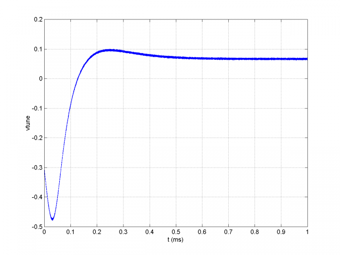

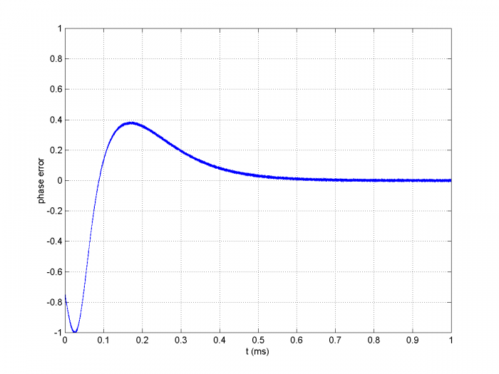

Note that the values of KI and KL used result in loop natural frequency of 2 KHz, with damping of 1.0. For a real-world design, we’d probably want to use a lower natural frequency (to minimize spurs and noise from the ADC), but I chose this value to keep simulation time manageable. Note that the loop bandwidth of the PLL is slightly greater than the natural frequency. The external clock frequency is 6.3001 MHz, and the NCO initial frequency is 100 ppm (630.01 Hz) below that.

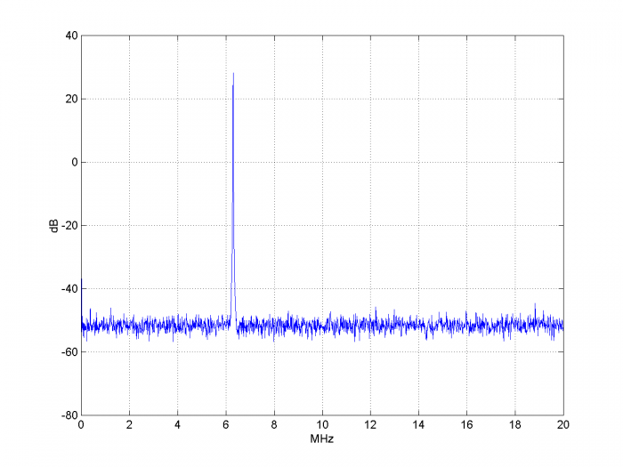

The simulation results are shown in Figures 8 through 12. Figure 8 shows the spectrum of the reference clock at the output of the 8-bit ADC. The highest spur is roughly 75 dB below the carrier level. Figure 9 shows the output of the phase detector as the loop acquires lock. The fuzz on this signal is caused by the Gaussian noise and ADC quantization noise. Figure 10 shows the loop filter output (vtune). Figure 11 shows the spectrum of the NCO cosine output signal. The close-in spectrum of the NCO output is shown in Figure 12. Note that the model does not include the phase noise of the PLL sample clock.
In Figure 11, the highest spur is more than 100 dB below the carrier level – an improvement of more than 25 dB compared to the spurious at the ADC output. This occurs because the spurious level outside the 2 kHz bandwidth of the PLL is attenuated by the PLL’s closed-loop response [4]. But given that the noise is amplitude noise, how does it affect the PLL at all? In the phase domain, you can view the noise as a vector modulating the tip of the clock signal [8] (See Figure 14 in the next example). The vector has an amplitude and phase component. The amplitude component does not affect the PLL. The phase component, if inside the loop bandwidth, appears as noise in the NCO output. If outside the loop bandwidth, it is attenuated by the closed-loop response of the PLL.
Keep in mind that in a particular hardware implementation, spurs may fall within the loop bandwidth and thus will not be attenuated by the PLL. The next example looks more closely at the attenuation of noise outside the PLL loop bandwidth.
Figure 8. Spectrum at ADC output.
Figure 9. Phase Detector Output.
Figure 10. Loop Filter Output (vtune).

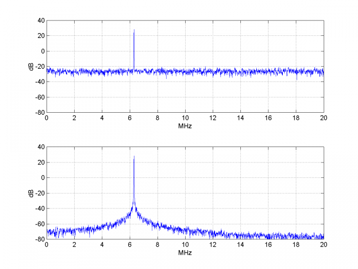

In this example, we’ll look at how the PLL’s closed-loop response shapes the noise of the reference signal. We’ll use most of the same parameters as in Example 1, but we’ll increase the Gaussian noise level. We’ll also change the loop natural frequency to 20 kHz and reduce the number of samples. These new parameters are coded as follows:
N= 20000 % number of samples
Vr= A*cos(phi_r) + .05*randn(1,N); % ref clock with Gaussian noise
KI= .0064; % loop filter integrator gain, fn = 20 kHz
KL= 4.1; % loop filter proportional gain, fn= 20 kHz
The reference clock SNR is 20log10(.707/.05) = 23 dB. It has the spectrum shown in the top of Figure 13. The spectrum of the NCO cosine output is shown in the bottom of Figure 13. You can see the shape of the PLL closed-loop response in the noise floor.

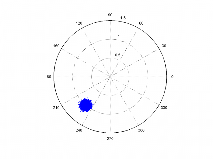

Figure 14 is a polar plot of the I/Q output of the Hilbert transformer, derotated to baseband. As discussed in Example 1, you can see that the phase vector is amplitude and phase modulated by the Gaussian noise (the noise causes the amplitude to exceed 1.0, which is a little flakey for a real application, but it works to demonstrate the concept). The phase detector computes the error due to the phase modulation, and the PLL attenuates components of the phase modulation outside the loop bandwidth. Figure 15 shows the I/Q output of the NCO, derotated to baseband: you can see that the phase noise is much less than that of the reference clock. Again, the model does not include the phase noise of the PLL sample clock. Figure 16 shows the increased NCO phase noise that results when fn is widened to 200 kHz.
Figure 13. Top: Spectrum of reference clock with added Gaussian noise. psd(Vr,2^12,fs/1e6)
Bottom: Spectrum of NCO output for loop fn = 20 kHz. psd(y(5000:end),2^12,fs/1e6)
Figure 14. De-rotated phase of Hilbert Transformer output, showing Gaussian noise of reference clock.

Note in my model Vtune sometimes exceeds +/- 1.0 during acquisition.
-- Neil

When the frequencies are not equal, a "beat note" appears at the output of the phase detector with frequency f = fnco - fref. This signal is not symmetric -- it has a dc component that, when integrated, drives the PLL towards lock. Lock can occur even if the frequency error is greater than the loop bandwidth. This is described in section 8.3 of Garder's book (reference 3).
However, if the frequency difference is too great, lock can take a very long time.
Here is a plot from Part 1, which uses a different phase detector, but has similar pull-in behavior. The plot shows the output of the phase detector during acquisition. As you can see, the PD output is rolling over. Note the dc component is not zero.
Here is a plot at the output of the integrator. As you can see, Vtune slowly builds towards the required voltage. Once the frequency error is within the loop bandwidth, lock happens quickly.
regards,
