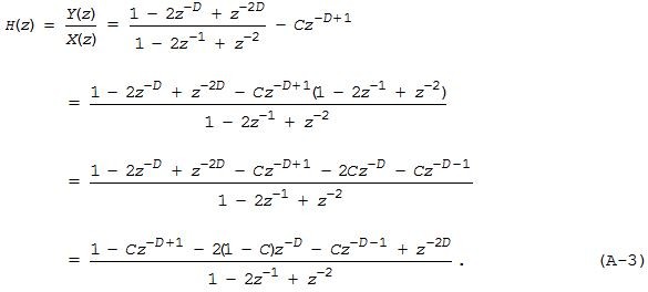

Appendix A: Derivation of Eq. (1)
The derivation of this blog's Eq. (1) is described as follows: The foundation of the proposed wide-notch comb filter is two cascaded Recursive Running Sum filters as shown in Figure A-1(a).
The z-domain transfer functions of a single RRS network and the cascaded Figure A-1(a) network are given in the following two equations:
We can eliminate one of Figure A-1(b)'s long delay lines using the proposed network given in this blog's Figure 2(a) whose z-domain transfer function is also given by Eq. (A-3).
