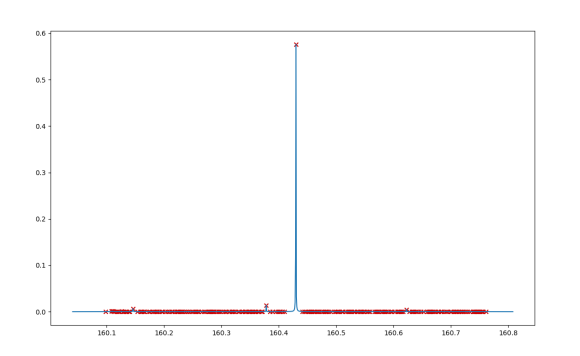

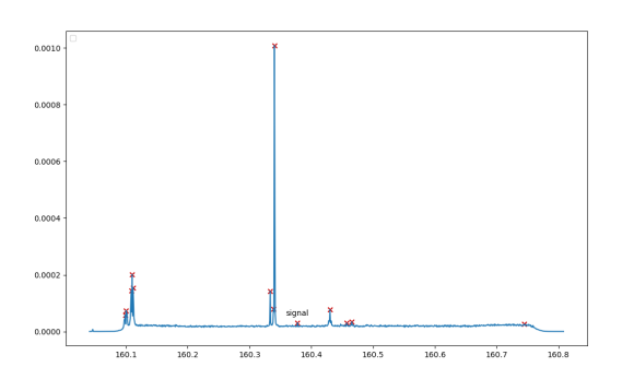

A example plot with prominence 0.00001 and a single signal of interest correctly identified at 160.377 is shown below. Note the other peaks are noise or DC spikes.
If a different set of samples from the SDR is then processed with signal.find_peaks with the same prominence setting of 0.00001 I get so many peaks the Rpi5 can no longer process in real time and samples are dropped: (Note signal of interest still on 160.377)
