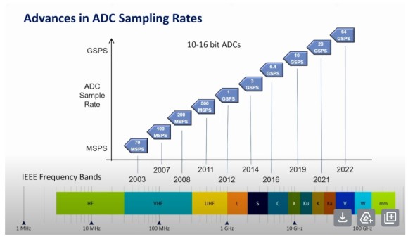

ADCs have increased in sample rate by 1000X in just the last 20 years (see below chart from Mercury). Yet the OFDM receiver's ADC samples at the signal bandwidth (exactly) because of FFT constraints. The dual-input (I, Q) FFT allows sampling at bandwidth vs sampling at 2X bandwidth (Nyquist) because of the complex versus real input. The estimated QAM values (Constellation grid points) that contain the data, will be identical for both designs. Note also that the signal received at the receiver antenna is real. It could be downconverted to baseband and sampled 2X to get the same results -- using a single ADC channel.

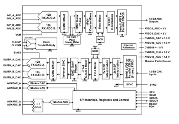

The motivation is saving an ADC channel with minimal penalty -- massive MIMO seems the trend in new architectures. Is a single ADC/filtering path at 40MHz, more power/complexity than dual ADC/filtering paths at 20Hz? Take a look at the TI architecture below (similar multi-channel architectures are available from ADI, Mercury/Intel, and NS). The as-presented 2-ADC path architecture is surely designed for I, Q from a single transmitter .. would freeing up an ADC path at the receiver offer a 2X throughput improvement?

A lot has changed in these decades .. (actually >50 years) .. ADC capability, massive/MU MIMU, Direct RF trends .. the IFFT/FFT Tx/Rx architecture really hasn't changed a bit in this period!
