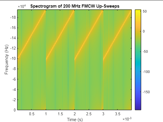

I created a simple FMCW sweep using MATLAB in baseband, BW = 100MHz:
sweepTime = 1e-3; % 1 ms sweep
BW   = 1e8; %100 MHz;
fs = 2e8;% 200 MHz sample rate
% FMCW waveform: only up sweeps
waveform = phased.FMCWWaveform(...'SweepTime', sweepTime, ...'SweepBandwidth', sweepBW, ...'SweepDirection', 'Up', ...'SweepInterval', 'Positive', 'SampleRate', fs, ...'NumSweeps', 4); % Repeat 4 up-sweeps
% Generate waveform
x = waveform();
% Plot spectrogram
[S, F, T] = spectrogram(x, 1024, 512, 1024, fs);
imagesc(T, fftshift(F - fs/2), fftshift(mag2db(abs(S))))
xlabel('Time (s)')
ylabel('Frequency (Hz)')
title('Spectrogram of 200 MHz FMCW Up-Sweeps')
colorbar
it plotted this

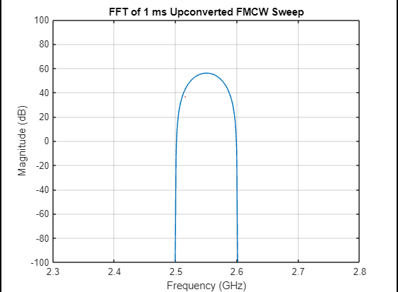

I then try to up-convert it to 2.45GHz,
%checking the sprectrol gram in RF
fc = 2.45e9 ;
% Extract the first 1 ms sweep (first sweepTime worth of samples)
N_sweep = round(sweepTime * fs); % Number of samples in 1 sweepx1 = x(1:N_sweep);                % First sweep
% Time vector for first sweep
t = (0:N_sweep-1)' / fs;
% Upconvert to RF (use same t as baseband generation!)
x_rf = x1 .* exp(1j * 2 * pi * fc * t);  % complex RF signal
% Windowed FFT for better spectral leakage control
X = fft(x_rf .* hann(N_sweep));
f = (0:N_sweep-1)/N_sweep * fs + fc;
% Plot spectrum (in dB)
figure;
plot(f/1e9, 20*log10(abs(X)))
xlim([2.3 2.8])    % Zoom in around expected sweep range
ylim([-100 100])
xlabel('Frequency (GHz)')
ylabel('Magnitude (dB)')
title('FFT of 1 ms Upconverted FMCW Sweep')
grid on
it then plotted this:
I am confused why is my RF FMCW starting at 2.5GHz while I clearly defined my fc = 2.45GHz?
Reply by fxbrainJune 15, 2025
The issue is that the baseband sweep shape is not centered as you'd expected.
To get a sweep centered at 2.45 GHz, your baseband must sweep from -50 MHz → +50 MHz, which is exactly what SweepInterval = 'Symmetric' produces.
Reply by shafie7June 13, 2025
Have you try using fs = 400 MHz instead of 200 MHz to see the impact on the output?
Reply by emebJune 13, 2025
