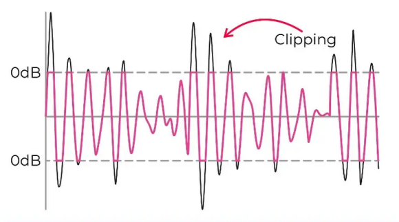

1. Added soft clipping (tanh) on the output of the preemphasis. This supresses some of the overshoots but the overshoots added by the FIR filter and upsampler remains. Also clipping the output of the preemphasis is causing IM so the audio is sounding harse.
2. Added soft clipping (tanh) on the output of the upsampler. This supresses most of the overshoots but the so the audio is sounding harse.
